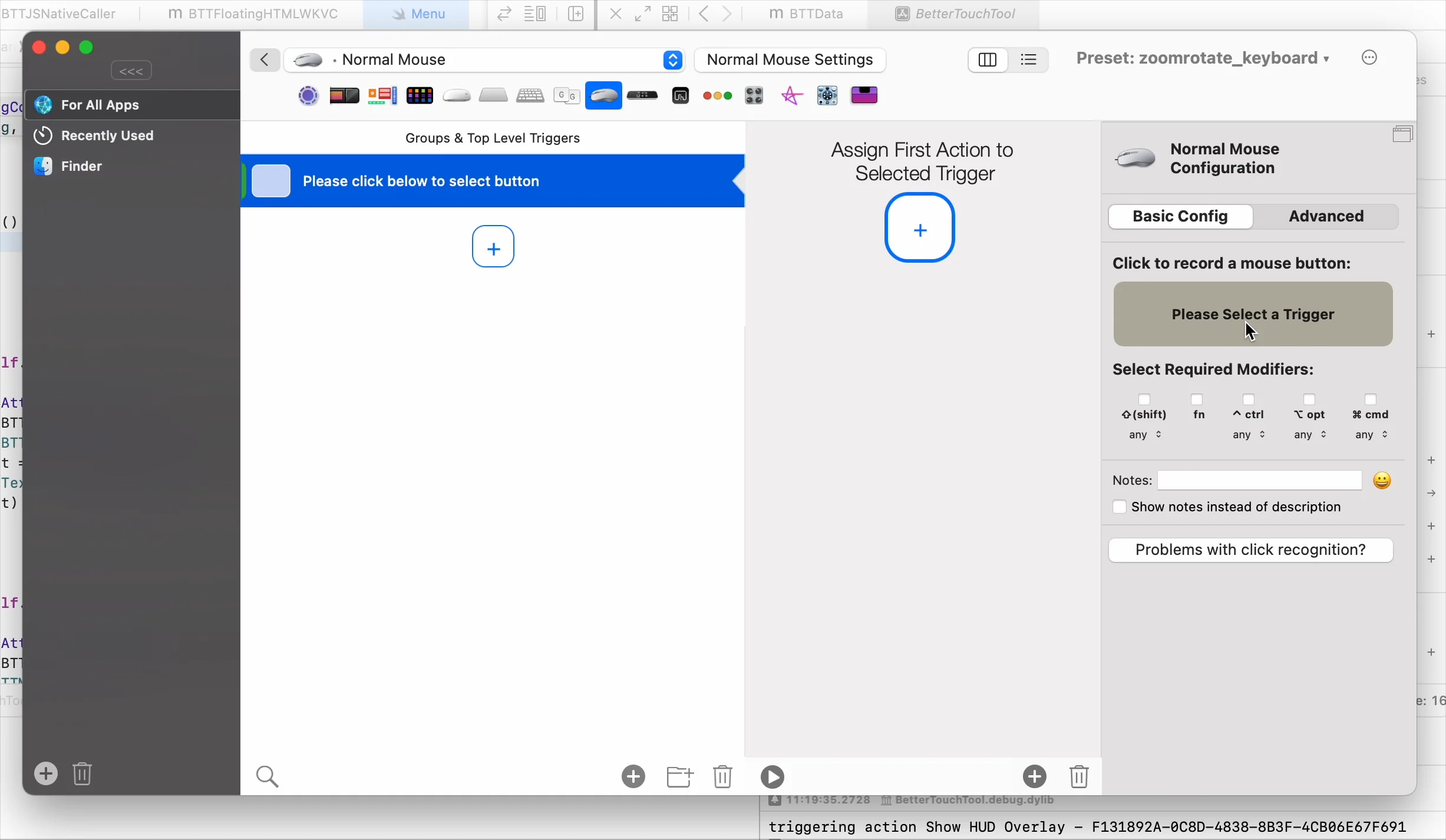

There is a way to do that:
Basically you record your mouse button in the normal mouse section. Then you duplicate that trigger (cmd+c & cmd+v). Then for the second trigger you set the advanced trigger condition "Trigger on Mouse Up".
Now you can assign the predefined action "Start Recording Drawing/Mouse gesture" to the first one and "Stop Recording Drawing / Mouse Gesture" to the second one.

Thanks for the tip Andreas, that's brilliant — but it still leaves me with one issue. Because that setup doesn't put the custom mouse button through same the Right-click setting that only activates the drawing if you move the mouse a certain number of pixels, I can't utilize just a single click of the custom button as its own action (without a dropdown list popping up every time I press it).
