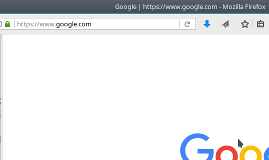

Ah Firefox.
Sorry, unfortunately after all these years Firefox still doesn't have any scripting support, thus BTT can't get the url from it.
You would need a plugin like this to instead move the url to the window title, then you could use the window name in your conditions:
