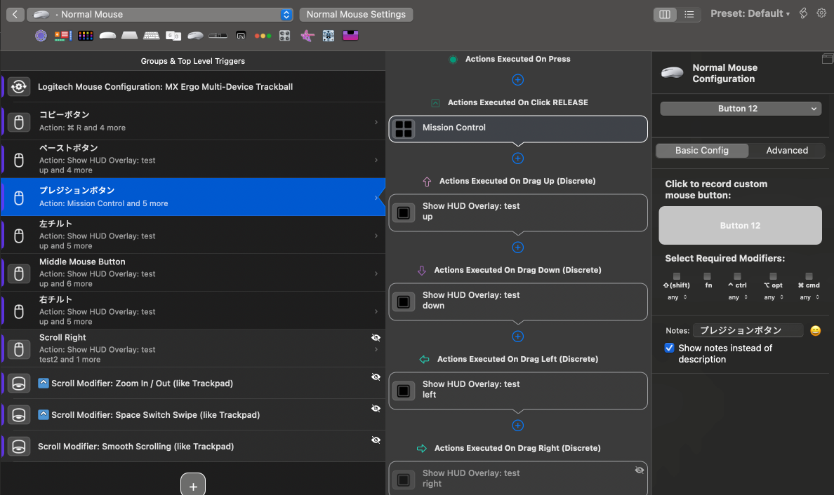

Affected input device (e.g. MacBook Trackpad, Magic Mouse/Trackpad, Touch Bar, etc.): Logitech MX Ergo
Screenshots
If applicable, add screenshots to help explain your problem. (You can just paste or drag them here)
Image from Gyazo
Device information:
  • Type of Mac: Apple M1 MacBook Air
  • macOS version: Sequoia 15.6.1
  • BetterTouchTool version: 6.093(please post the exact version - not just "the latest one")
Additional information (e.g. crash logs, related issues, etc.):
Issue:
When connecting an MX Ergo mouse via a Unifying Receiver, the Precision Mode button(show as Button 12 in BTT) cannot be fully remapped. Specifically, even after enabling the "make all buttons available for remapping in BTT" option, the default Precision Mode toggle setting persists and cannot be overwritten.
Expected Behavior:
For example, when the Precision Mode button is assigned to macOS Mission Control (as shown in the screenshot), pressing the button should launch Mission Control.
Actual Behavior:
Mission Control launches, but simultaneously, the Precision Mode also toggles. This issue does not occur when the mouse is connected via Bluetooth; it only happens when connected with a Unifying Receiver.
The Unifying Receiver and mouse pairing were performed through the BTT UI.

Yes, I post the bluetooth oneπŸ™‹β€β™‚οΈ
can you check whether 6.098 fixes the unifying receiver issue? (uploading now)
Updated to Ver 6.098. The precision button remapping appears to be working correctly.
Only the remapped action is now activated, and the default precision mode toggle no longer occurs.
Thank you for the quick fixπŸ™Œ
