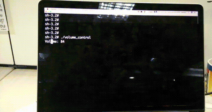

I should do that and post it here: https://uxdesign.cc/the-worst-volume-control-ui-in-the-world-60713dc86950
yes! ![]()
Damn it! Someone already did!
https://miro.medium.com/v2/resize:fit:720/format:webp/1*x96b41G9y84eC--p18ghcQ.gif
haha too bad ![]()
