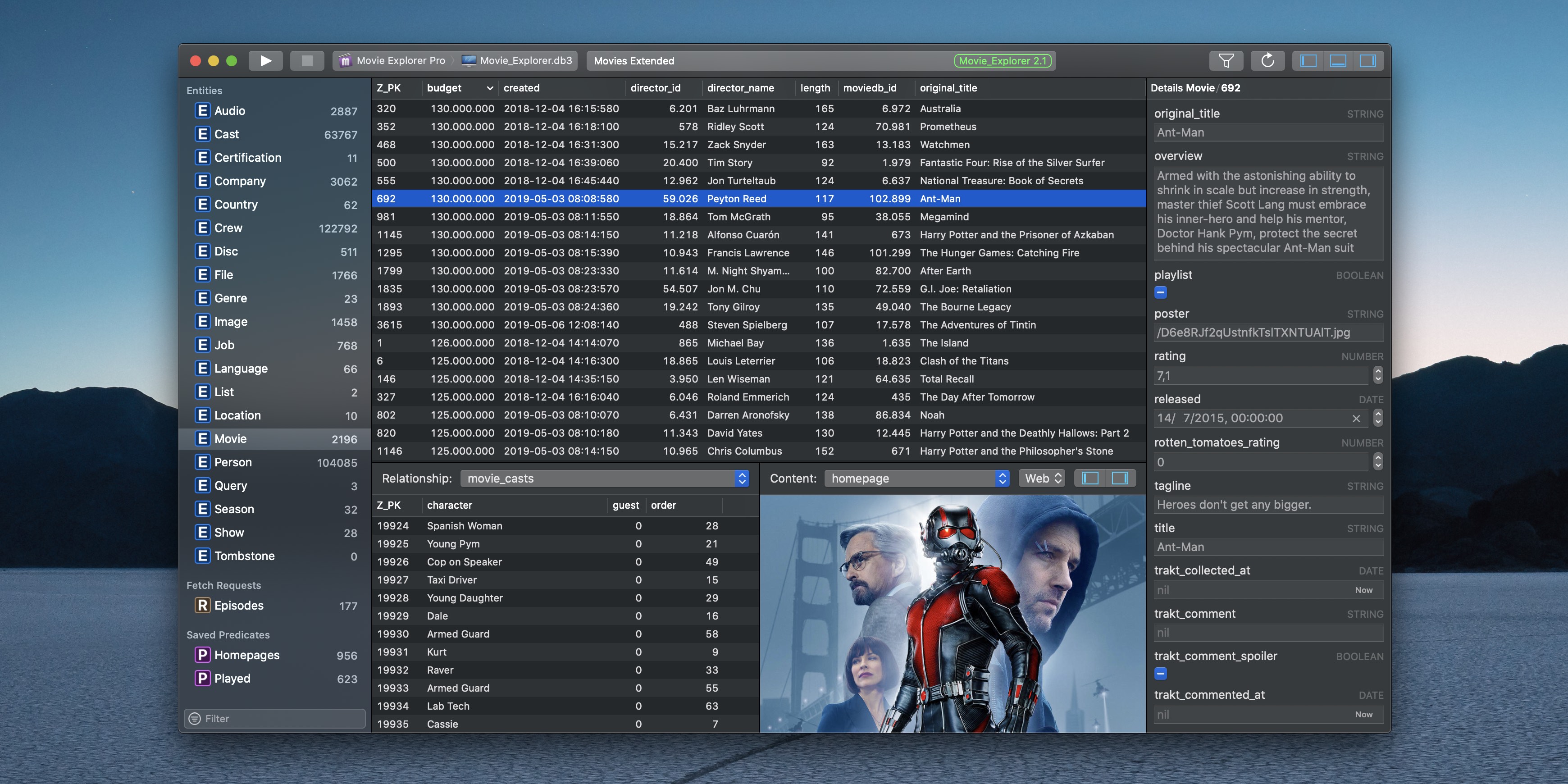

This tool can open and view these databases nicely, there is a 14 day trial:

In the BTTClipData DB table this item have nil for both data and uuid:
Here's screenshot from the BTTClip table:

would you be able to export that trigger from the database tool and send it to me? (right click => export to json, "include to many relationship data", andreas@folivora.ai)
